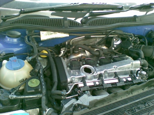

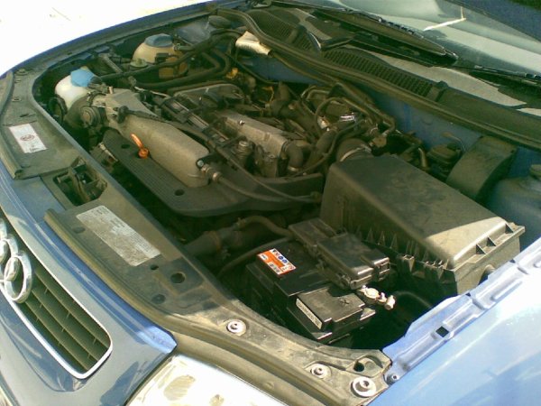

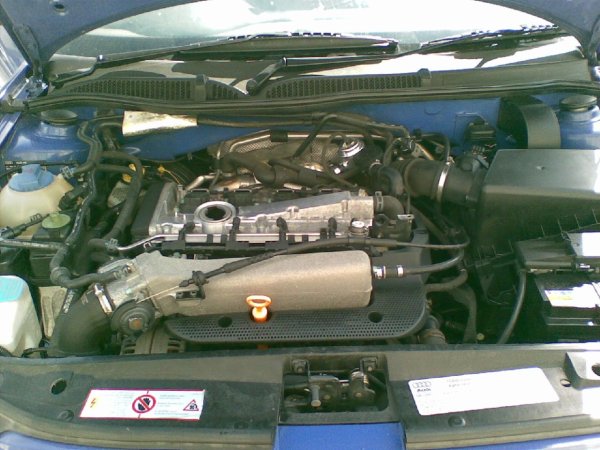

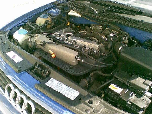

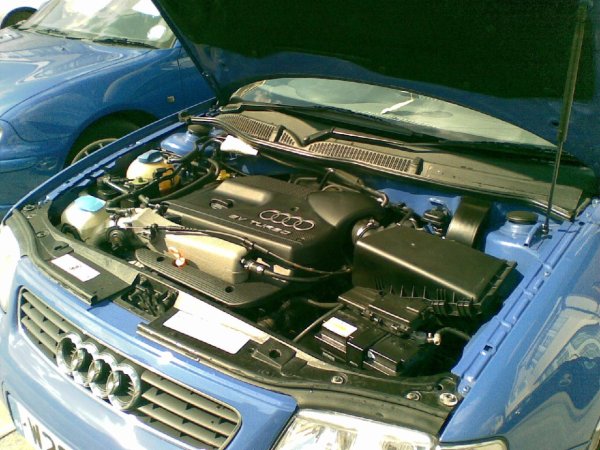

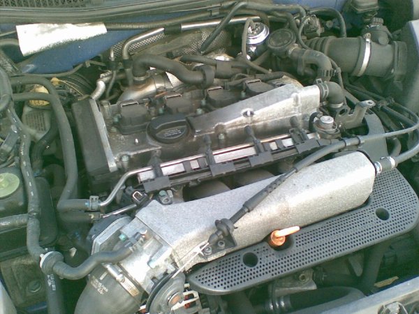

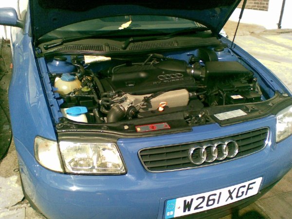

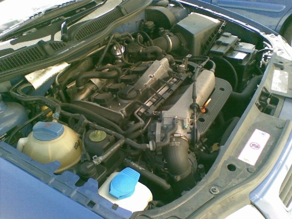

A little clean for now:
pictures taken from phone camera....
corsa engine bay pics taken using proper camera
before
during:
after:

take off that bonnet carpet

if your tuning, deffo remove the carpet. and the plastic engine cover

Did you polish the cam cover or just clean it?
abdus
Registered: 23rd Feb 06
2nd Jun 07 at 21:05   View User's Profile U2U Member Reply With Quote
just cleaned it, used some Tetroclean engine degreaser with paintbrush on a warm engine, waited for 2-3 minutes, then jet washed it with the super B&Q pressure washer (i think that made the differecne )

Yes gunk, but I've used both a CarPlan tetroclean works better...
I just warmed the engine (not hot), used a paint brush to spread the degreaser, ( a little hard where needed), then leave if for 2-3 mins, start engine, pressure wash it
I didn't cover anything but don't stay too long with the hose near electric
then use some rubber and vinyl care
abdus
2nd Jun 07 at 22:35   View User's Profile U2U Member Reply With Quote
Originally posted by Wonderboy
Is it ok to use a pressure washer in the engine bay? With all the wires/sensors etc...?
both engine you see in the pictures have been pressure washed with nothing at all covered.
Just leave engine running...
Don't do it if you have an induction kit

the degreaser will loosen the dirt and grease making it easier when washing off...
Pressure wash it with medium spray but don't stay on the same area for too long.
I use high pressure near the gearbox etc.... near electric electrics, you don't need high pressure, just light spray.
Took me 13-15mins max to do this
