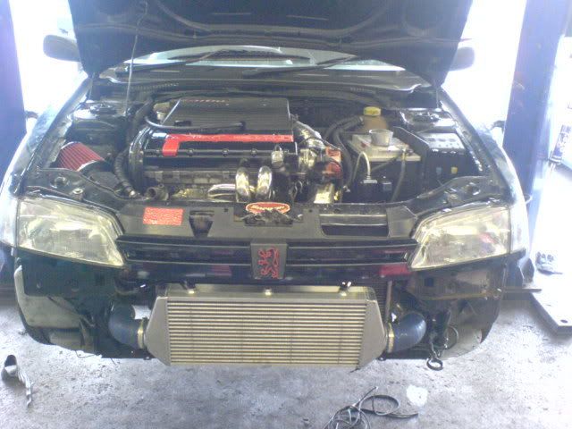

Nice to see a 306 with a decent engine in for once

looks abit messy, looks as though its still being worked on though.
is it running?

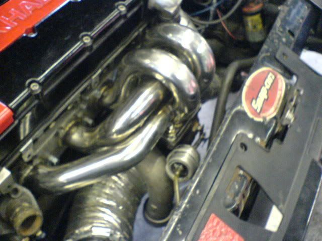

a guys on a 306 forum i go on,
close up of the new gt2876r bb turbo.
Apparently has bigger 440cc injectors and phase 4 eds software.
Engine spec :-
1 - Low comp pistons
2 - Arrow steel conrods
3 - Arp rod and head bolts
4 - Steel head gasket
5 - Garrett gt28r ball bearing turbo
6 - Nissan sr20det high flow equal length exhaust manifold
7 - 3" turbo back exhaust system with just a backbox
8 - EDS phase 4 ecu with switchable boost control
9 - Racetronix 440cc fuel injectors
10 - Aquamist water injection
11 - Large front mount intercooler with all 60mm boost pipes
12 - Regal 60mm tophat
13 - Regal high flow external fuel pump
14 - Cone air filter
15 - Xe inlet cam
16 - ported coscast cylinder head

the 1st one? err engine 4ft infront of the wheels???
and drive shaft angles ?!

what BHP is that second pug running?

I *think* the engine is tilting forwards. If you look at the first pic? Not sure...
Does anyone know what transmission it's running?

in fairness i am looking on a phone screen so it may just be the photo. 2nd one looks better

I noticed that
Even if tilted forward that's some serious angle compared to how the second one looks.

not sure seem to remember 300bhp banded about,

nussys (the black1) would be alot quicker if he ditched the phase 4 and got it custom mapped . not sure if hes got it running properly yet tho? he used to have probs with it cutting out and boost probs ??

on his sig it says he is switching to megasquirt, and i think i was a reply of his mentioning a proper map.

The angle of the engine makes nigh on no difference. It's the way the box sits that counts. The original 306 engine lies back the way. Head towards the bulkhead and sump close to the radiator.

Wasnt just reffering to drive shaft angles, was also thinking about the 70kg lump that is infront of the front wheels which would make for some pretty shocking understeer i would imagine!
