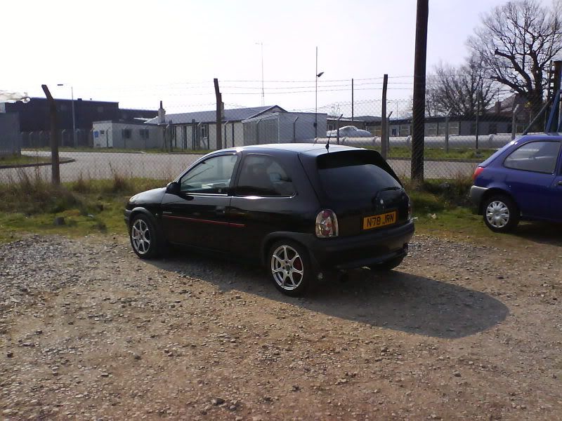

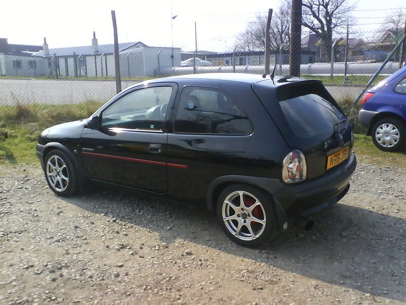

Just thought id post up a few pics of my Corsa 20XE. Fitted it all with my dad and its now done about 5k with only a small problem with the AFM, caused by a rather large puddle. Other than that its ran like a dream
Went to give it a run out on a rolling road today but found out that its running a rather extreme 1.45 degrees of neg camber both sides so kept slipping the rollers & messing up the readings. Il post up a printout of the results once I get the camber re-adjusted. Did find out that its running abit too lean at 1/14.6 ratio but the bhp & torgue ballpark figures looked about right from what we could tell so nothing major wrong
Going to get a custom DTA map sorted in the summer so can adjust the fueling etc & optimise a few other bits. The guys I went to knew their stuff pretty well

has that ''1.2 16v that a 17 year old lad would buy'' look about it
bet you've embarrassed a fair few

Nice, just change the wheels & lights, then lower it a bit.

smoked rear lights and lowered. Looks in great condition for its age

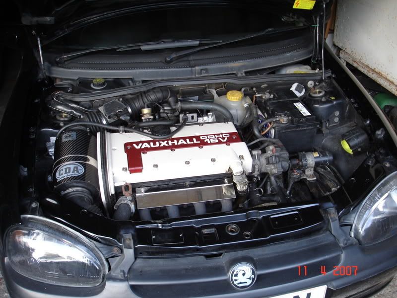

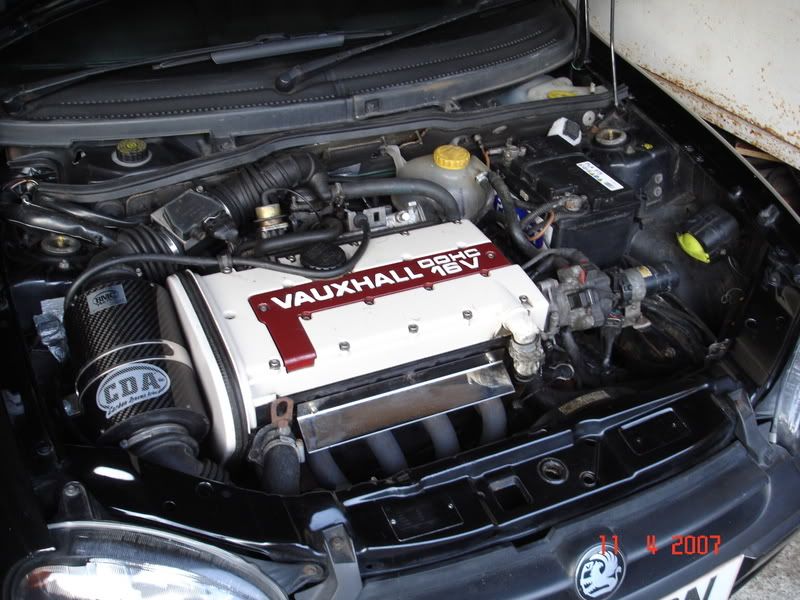

Just added a few engine bay pics
Sorted the camber and its booked in for rolling road again next week.

enigine looks very clean and a very tuidy conversion

i see it has a proper CDA
FruitBooTeR
Registered: 18th Jan 07
13th Apr 07 at 13:40   View User's Profile U2U Member Reply With Quote
U know the CDA filters where does the front intake pipe go? It doesnt just dangle does it.
whitter45
Registered: 15th Nov 02
Location: Norton
13th Apr 07 at 13:43   View User's Profile U2U Member Reply With Quote
ask Dave A
Na it drops down and is held in place just behind the lower grill mate. It was a bit of a squeeze but the feed is big enough to ensure nothing is restricted. I had thought of having it down the wheel arch which would have been alot easier but id heard too many things about crap off the road getting chucked up into the feed. Decided that it would be worth the extra hasstle to get it behind the grill and so far had no problems
