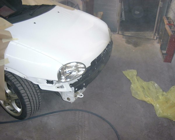

Some of you will remember that I had a little crash about a week ago.
Well.....
The V- Grille was only balancing on, I had some time on my hands today, so i decided to try sort it out. The bracket has snapped, but I discovered something behind the Grille.......
How much will this cost to repair?

Dont they just unbolt, replace with a new one?

jus buy a new crash bar

EXACTLY the same what happened to mine when i had a front ender, i think they jigged mine out though

bumper off, 2 bolts either side iirc, straight swap
i have a mint condition one of my gsi you can have for £15+postage to llandudno or you can pick up if need be from liverpool

I'm sure they are bolted to the front of the chassis rails that run through the engine.
Not sure on the prices, sod all from a scrappy i'd imagine......think the bolts are a bugger to get out........might have a square head, cant remember.
there 13mm bolts or so, standard...
2 bolts hold the bar onto the mounts, and there then bolted/slipped onto the front of the chassis where the lower part of the slam panel is.
really are easy to undo!

Held in with 4 13mm bolts, take about 4 minutes to get off including the bumper, if you've done the bumper before.
Scrappy won't want much.
I threw one away IIRC.

The GSI one will fit mine though won't it?

should do, your round my way anyway tomorrow as you said, wont take long to see
all the same tho iirc
21st Dec 06 at 18:00   View Garage View User's Profile U2U Member Reply With Quote
yes, they are all the same.

yes just checked myself, thought there might be a slight difference, but not!
