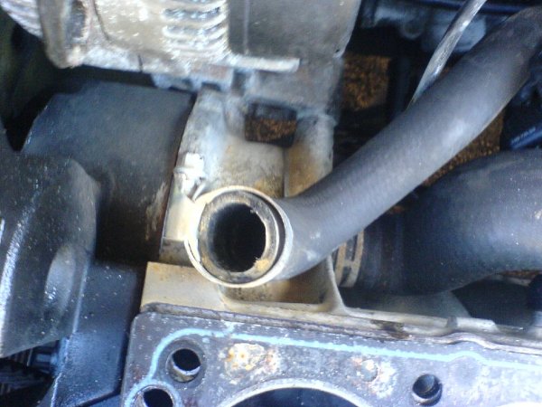

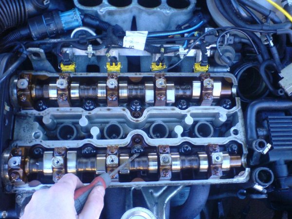

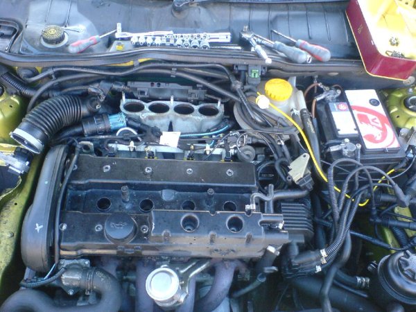

After a few texts to robin it was decided to pull the head off and see what caused the engine to run out of water....
upper inlet off:
locating the head bolts:
head now off:
originally we thought the head gasket had gone, i felt guilty about this as i did the head gasket anyway after pulling hte head off i found the cause of the water leak, the water hose on the back of the head had worked its way off:
the heagd gasket is fine:
but the head is warped now due to the engine over heating.... never mind! time for new engine and more power i do believe!

haha, it was pissing out of that area, but that pipe cannot be gotten to easily with the engine all in one bit...

Isnt it quite an easy fix just getting the head re skimmed etc or am i totally wrong..
broster
Registered: 6th Dec 02
Location: Drives: E39
15th Feb 06 at 11:46   View Garage View User's Profile U2U Member Reply With Quote
skimming it is a £20-£30 job if i remember correctly.

broster - is tht the pipe that is inthe middle under the manifold?
if soo its a propper arse to get back on wen engine is in , dunno if u remeber my water leak, well thts wut it was
broster
15th Feb 06 at 18:32   View Garage View User's Profile U2U Member Reply With Quote
the one in the middle is a bugger to get to! it was the one on the end of the head above the water pump housing
