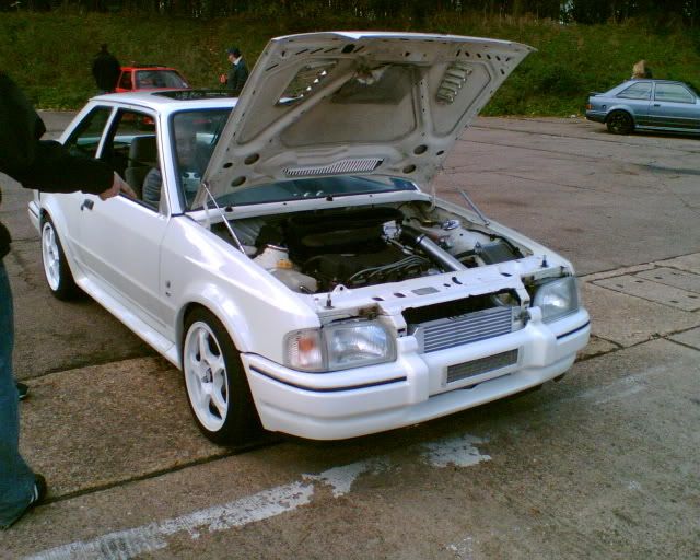

CVH 1600cc - 8 Valve.
Farndon H-Section Steel Conrods
Ross Racing Forged Pistons
Low Comp
Full Lightened & Balanced
525cc 6-Nozzle Injectors
GT28 Roller Bearing Turbo with Inconel Turbine Wheel
Modified RST Exhaust Manifold
Custom 3" Downpipe with V-Band fitting
Omex 710 Management
Blitz SBC I-Color Boost Controller
GRS EVO5 Intercooler
Alcon 6-Paddle Clutch
Uprated Gearbox
Plus more!!
It runs almost 2 Bar of boost and the Injectors are practically maxed out at over 3 Bar Fuel Pressure.
It also has 330mm AP Brakes with Brembo 4-Pot Calipers. The Brakes have been fully repiped in Steel Braided TFE Hose with Front/Rear incar Bias Adjustment.
The suspension has been fairly heavily changed too, including a Turbo Technics ARB Conversion with Adjustable Tie Bars and TCA's

Whys it got different steering wheel and clocks too the pictures that where up a while ago?
6th Nov 05 at 21:45   View User's Profile U2U Member Reply With Quote
what to the pics i put up
if so its because its a diffrent car
Tony Turbos 313bhp one (the one i went out in)
Christians from APT's one (168MPH one in the vid)
[Edited on 06-11-2005 by jr]
