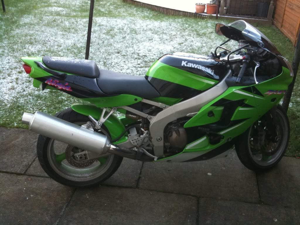

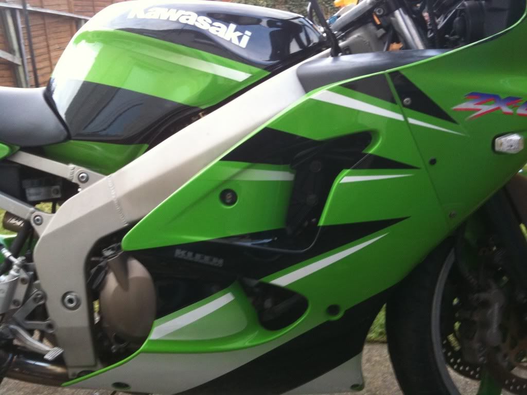

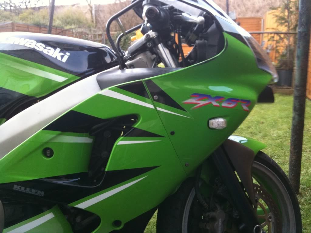

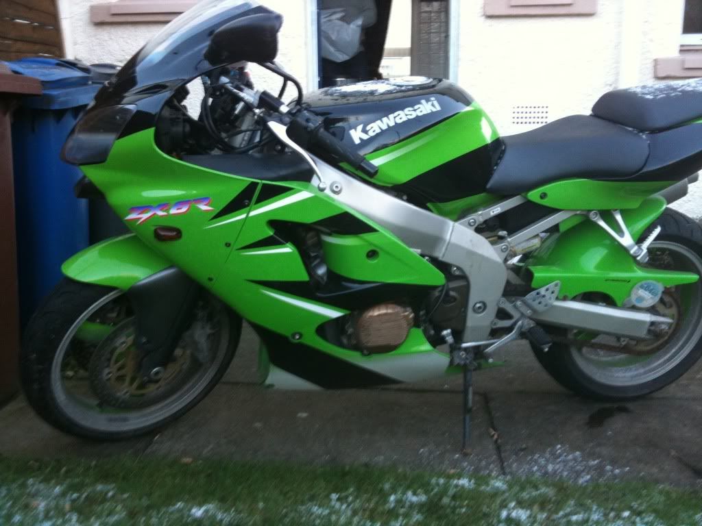

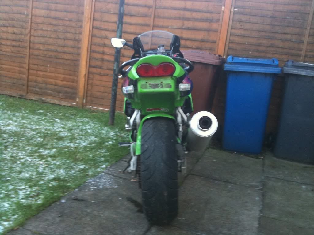

Thought i would start a project thread up for the bike seen as i havent had a project thread for years now....
heres some pics the now, will get more when new parts are fitted!

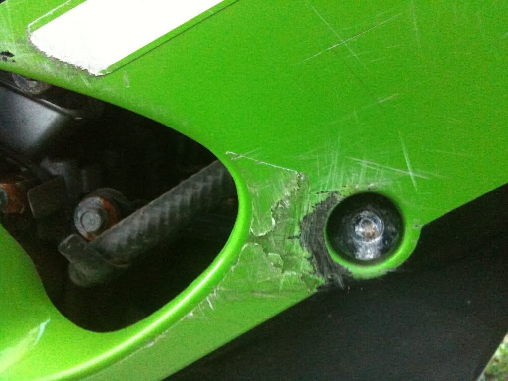

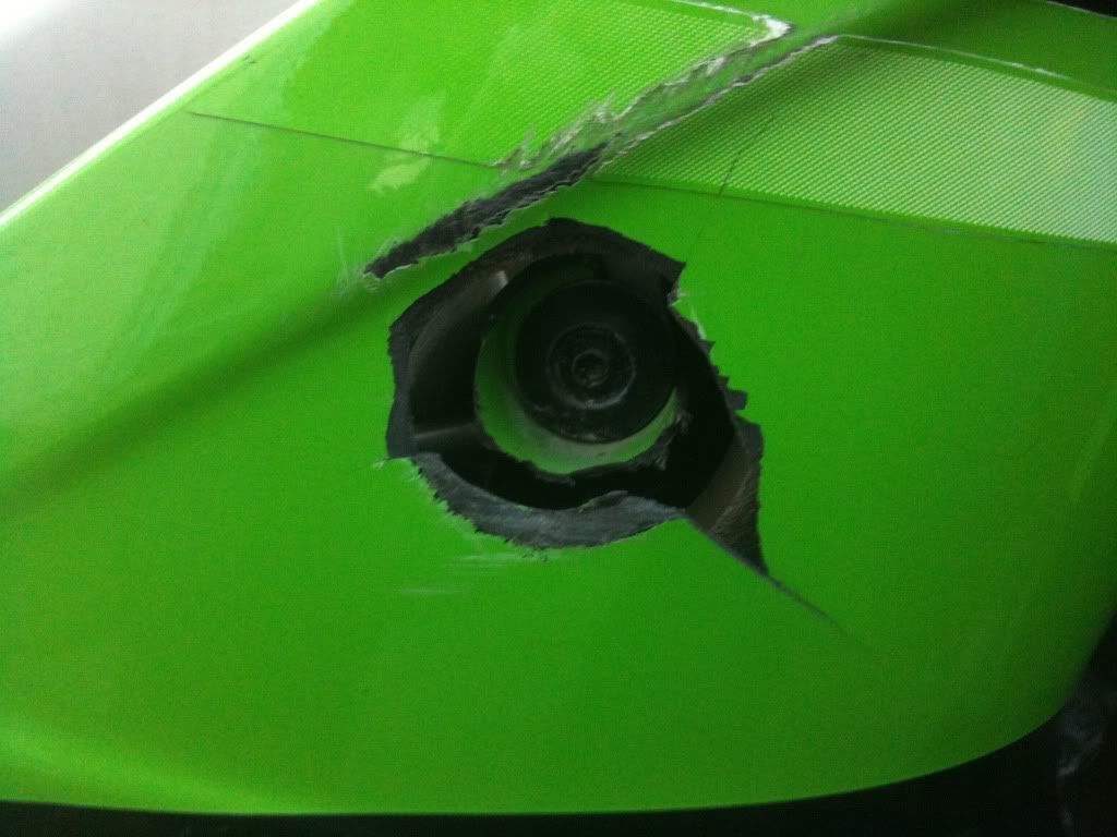

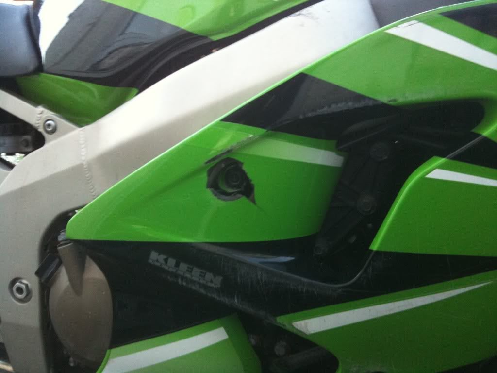

Now for the broken bits which im scouring the net for to get bits already....
Just on the one bit of fairing is the damage quite bad, its still all secure enough but doesnt look fresh when you are close up...
Got the rearset and the clipon coming this week then need some road tax

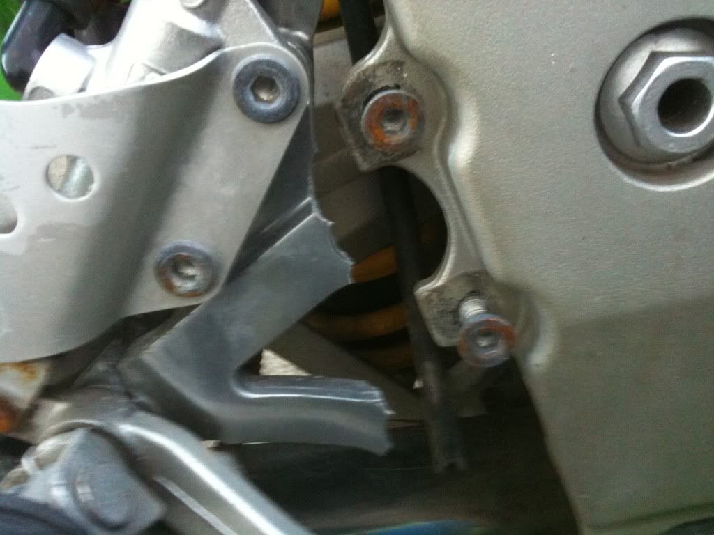

set about getting the rearset and clipon today,
rearset one of the bolts is chewed on the footpeg so couldnt get that sorted...
opened up my clipon to discover it was for a G model and not a J1 that was advertised on ebay...

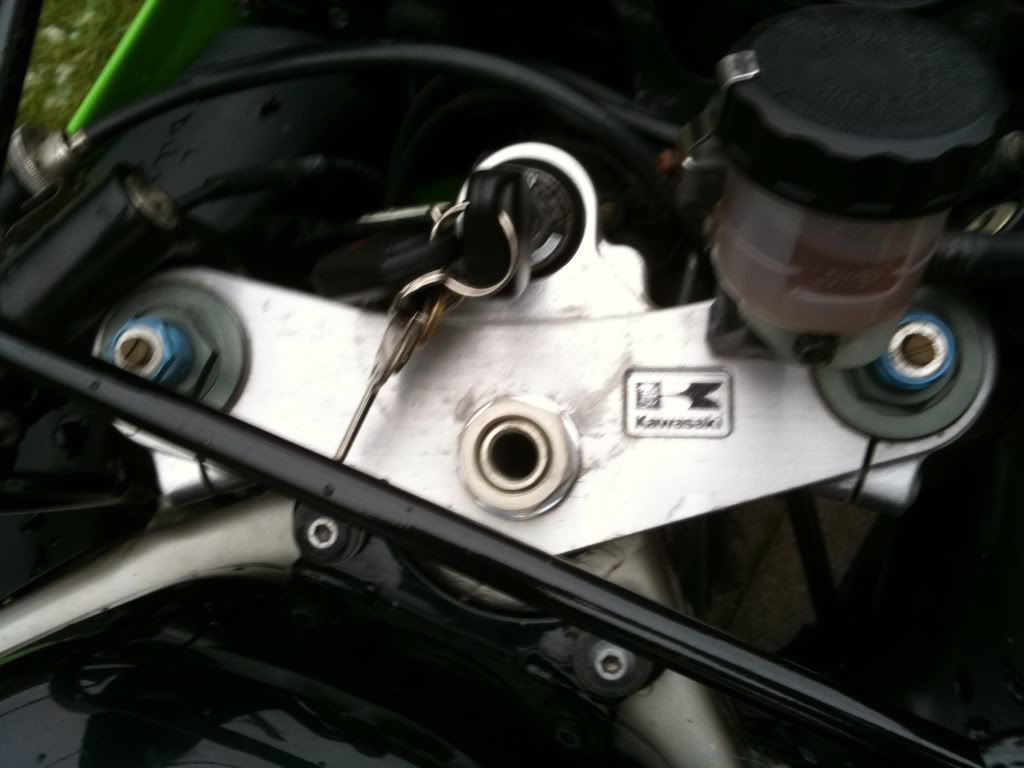

also need a bit of help......... has anyone fitted a clipon before? what do i need to take off? just the top yoke or what? then am gona have to get the tracking done again right?!?!?
whats to come off in this pic to get to it???

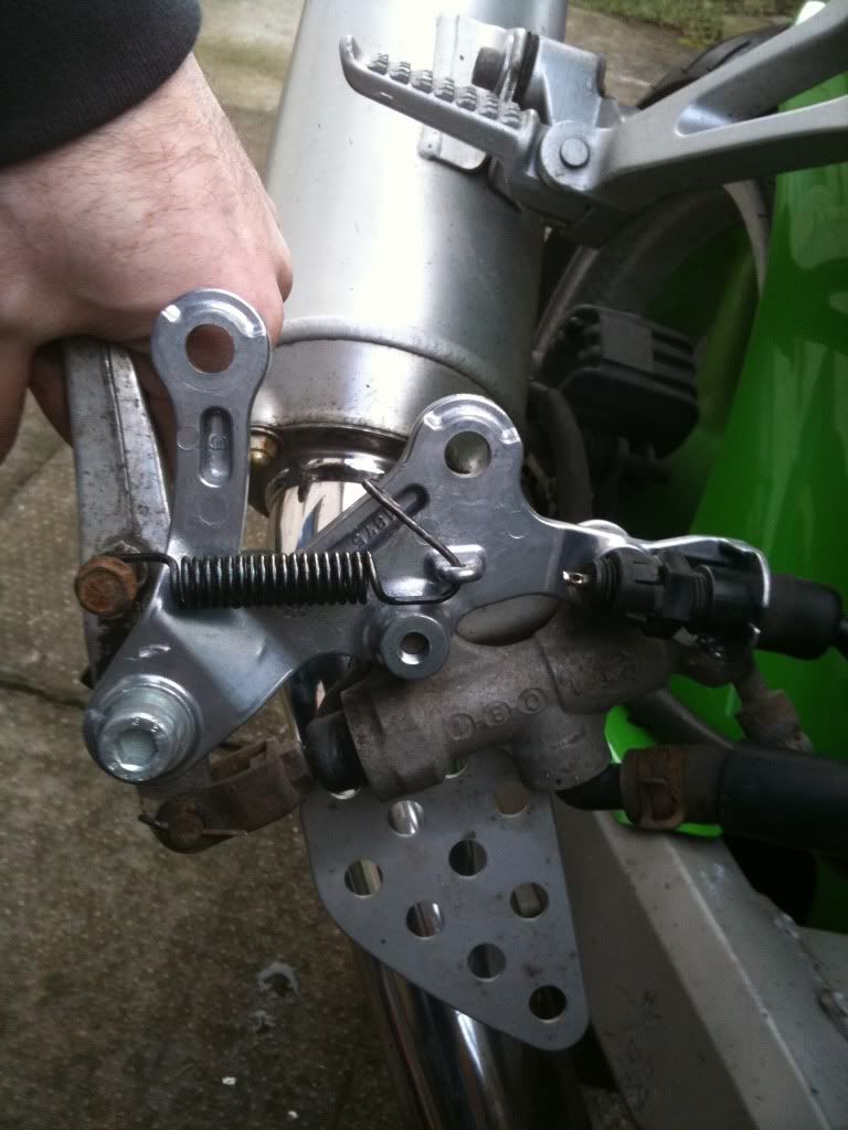

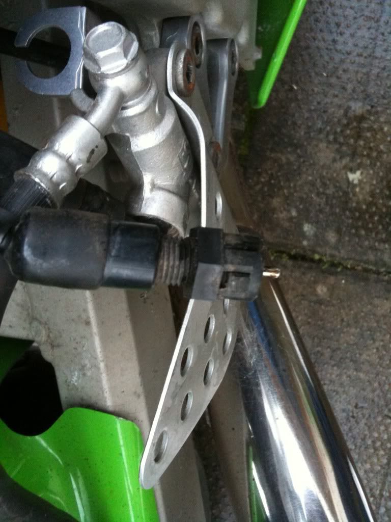

also when i got the brake light cable was off... couldnt see where it goes?
does it sit onto the brake pedal spring???

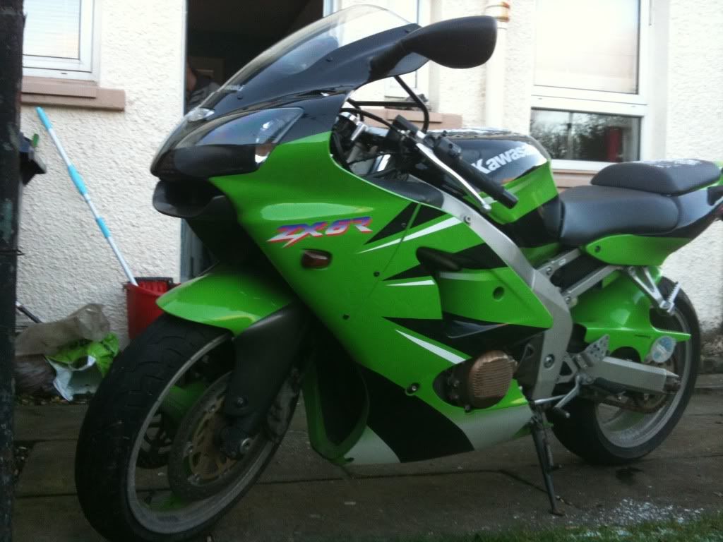

And another pic as i took a few today!!!

Ill get a pic of the brake pedal for you tomorrow.

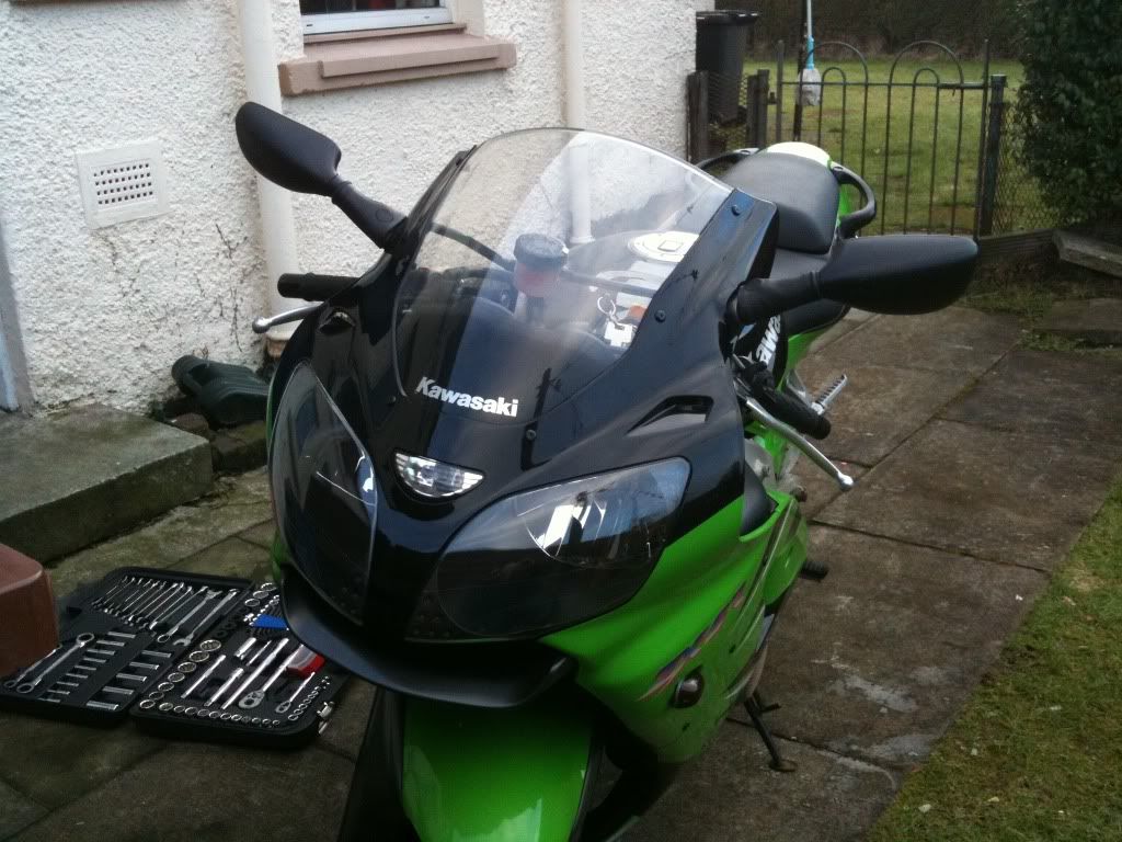

small update, thats the bike basically done now,
new fairing, clip on, rear set, indicator and mirror, all for the grand sum of about £180.... so £580 all in including bike....
defo got a bargain i think!!!
one problem i do have though is the rear brake light, ive fixed it up with a cable tie at the moment so that when i step on the brake pedal it does come on, but this aint supposed to be the way it should be and i need an MOT asap...
you can see in the pic the cable with the small hole that should connect somewhere to activate the brake light, i was under the impression that this should connect to that small spring, but no chance that it is going to come down that far, and also tried the spring both ways and no luck.,,,

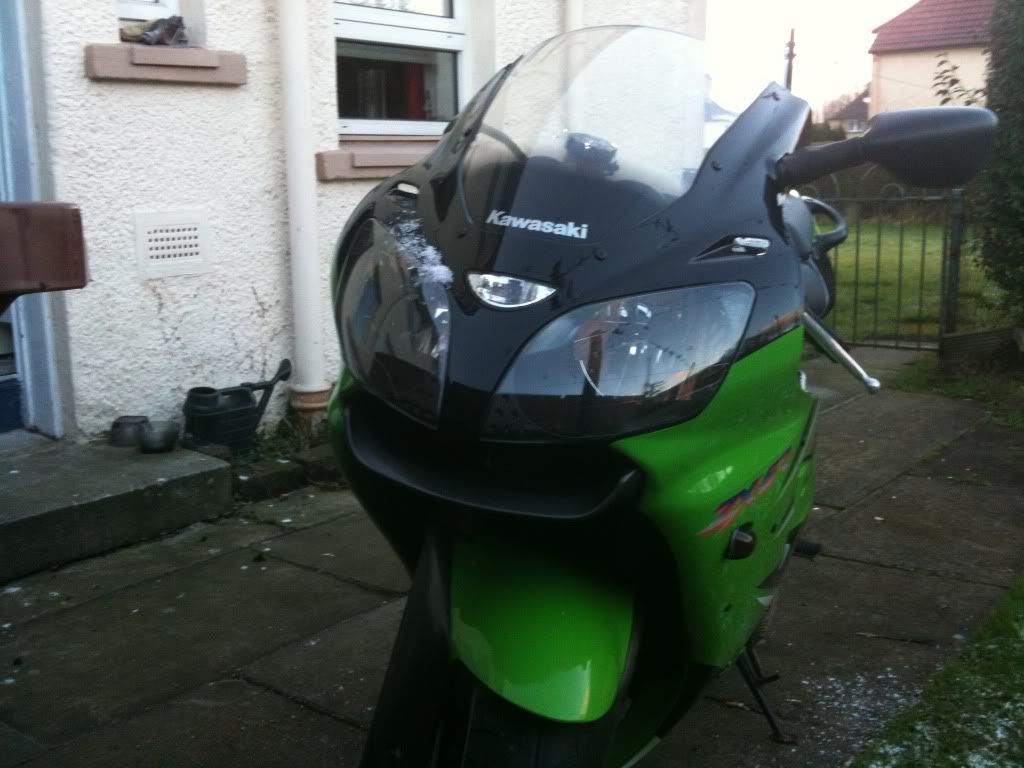

and one with 2 mirrors at last
ALSO, is fast flashing indicators an MOT failure? they are working, just a litttle faster than they should be lol

Looking good mate i think another little spring is needed to get the brake light switch working, and fast flashing indicators is a failure unfortunatly, you will need a new relay for smaller indicators.
Welsh Dan
Registered: 23rd Mar 00
28th Feb 10 at 00:41   View User's Profile U2U Member Reply With Quote
Re. fast flashing indicators? Just one side, or all?
If its one side, its a bulb gone on that side. If its all, its the relay thats wrong. Often if you change from indicator bulbs to indicator LEDs it causes the same thing.

what does this other little spring look like then for the brake light switch??

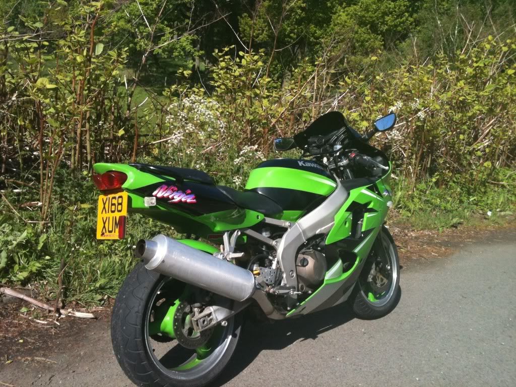

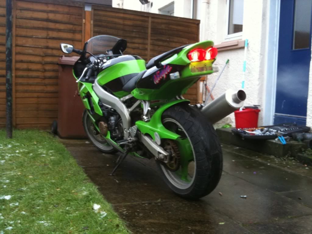

few new pics from a while ago,
just been enjoyng having a blast on it now that the weather is getting pretty good any excuse and am out
will try get some decent pics of it soon
