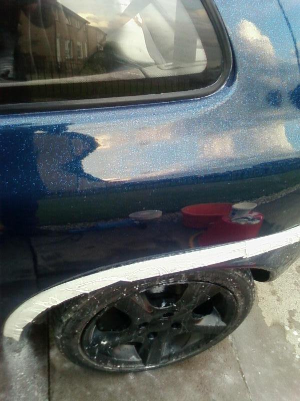

Bought the cheapest rotary I could find on ebay, using the pads it came with and some 3m fast cut plus I had lying in the garage.
Started with a waffle pad and the fast cut is the second most aggressive by the looks of the label, after splattering polish everywhere and braving it up to 3000rpm I thought I'd made a mess.
Got another flat pad out and stuck some meguiars normal hand polish on it, didn't go quite as fast, polished up lovely, I've got nearly all the old swirls and scratches out.
I'm going back to finish the bonnet soon and I'll see if I can get some pics.
I've managed more in 10 mins with a £50 rotary than I did in 2 days with a meguiars g220.
I've got an old astra to practice on, I wouldn't recommend trying it on something you were worried about.

John
Registered: 30th Jun 03
4th Oct 09 at 15:27   View User's Profile U2U Member Reply With Quote
This one
It's not got the speed control thing that keeps the speed constant even if it's being laboured, wasn't much of an issue so far.
If you were using it day in day out as your trade it's fair enough buying a more expensive one, from my experience so far though that one would do a hobbyist fine.
Pictures are really difficult to get in natural light, garage has been stolen though so that's all I had
Couldn't get anything of use of the bonnet at all, tried a rear quarter though.
That is the side I didn't do, I have no before pics but it was in exactly the same condition.
These aren't detailing world style but they are taken on a dull day straight off my camera onto here, about as good as I can get.
I know there is still orange peel and it's not immaculate but it's amazing for half an hours work and my first try imo.
It's also a flat paint with no laquer, I've not had the bottle to go too deep as the pad was already covered in blue paint.

Cars come from factory with orange peel so unless u flat and polish it u won't really get rid of it, there will b loades of paint on there to flat though but not really worth it.
Those polishers r very good for the money!
