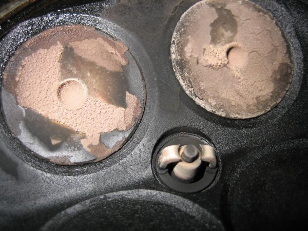

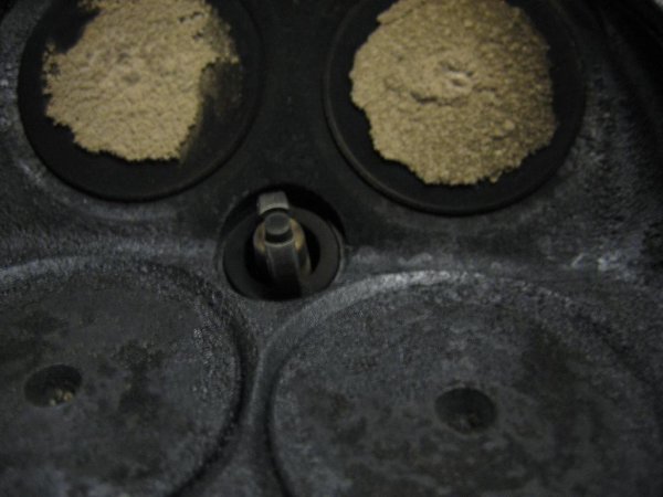

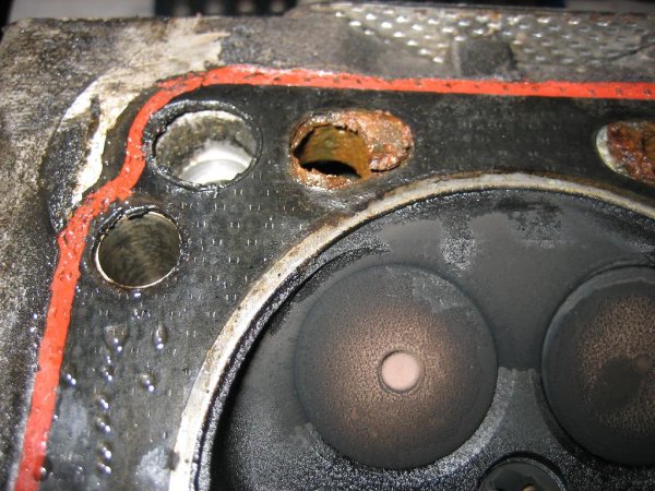

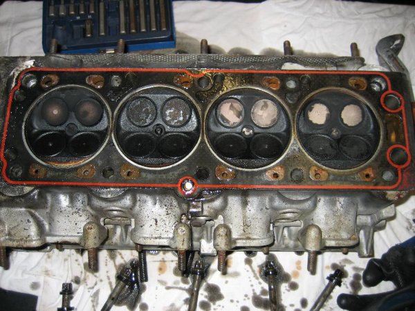

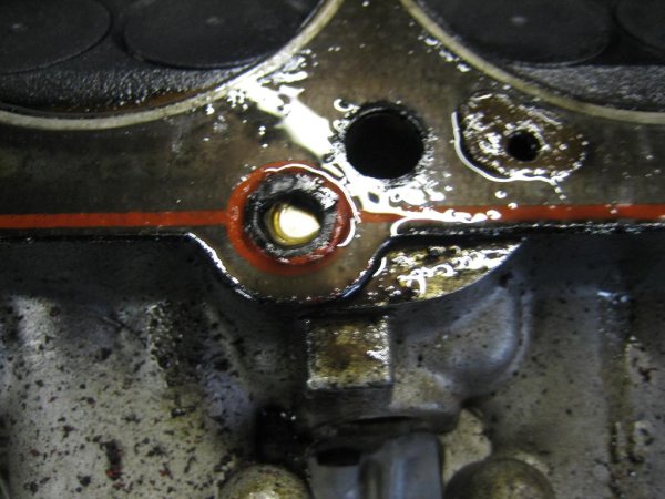

Had shit compression in 1&2, then lost loads of power the other day.
Wipped the head off and it looks poorly in there.

Why do you think its going?
Getting hot? Dirrty water? Using oil?
Twiggy
Registered: 15th Oct 04
23rd Jun 09 at 19:48   View User's Profile U2U Member Reply With Quote
using more water than the population of Birmingham.
Presurising the header tank
Thick "grease like " oil in the breather pipe
Water where the cams and shit are.
Running on 3/2 ish?

When it went on the rollers to get it tuned, he said it had shit compression on 1&2 but set it up just to get by. Thought it was piston rings so left it till the weather went bad to do a rebuild.
On Saturday morning, under acceleration, it just lost all power. Replaced the coil pack as it seemed 2&3 had a shit spark. Didn't make any difference, so whipped the head off as it had all the symptoms of a gasket failure between cylinders.
