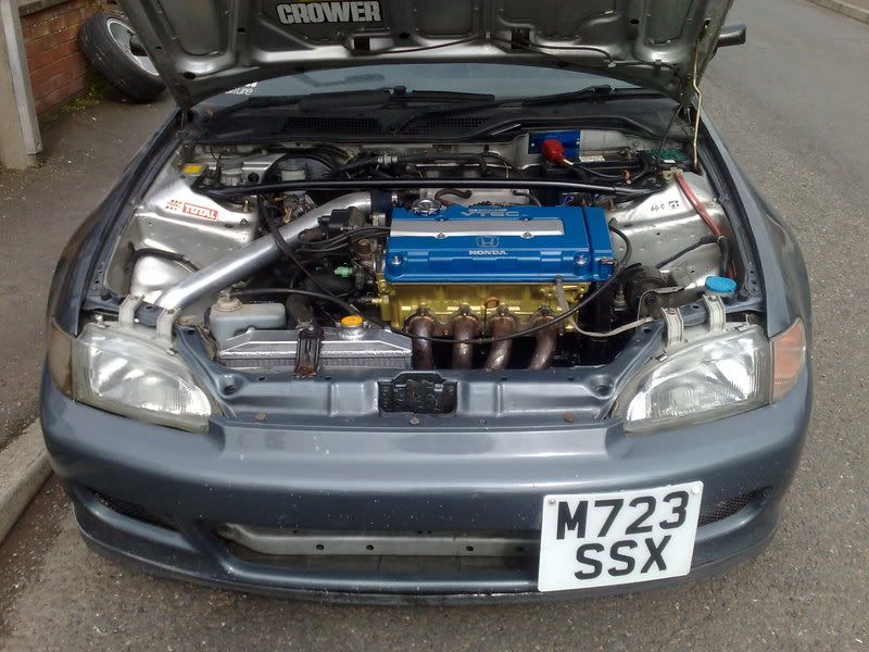

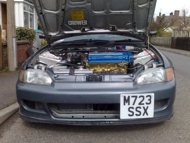

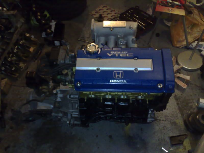

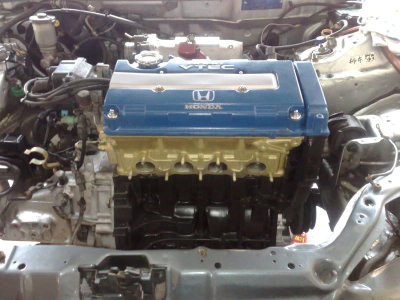

Hes been building this up for nigh on a year now after killing his 202.5BHP B16A2.
Its a B20B3 with a B16A2 head conversion (2.0 with 1.6 head for you non honda guys)
Fair spec on this now...

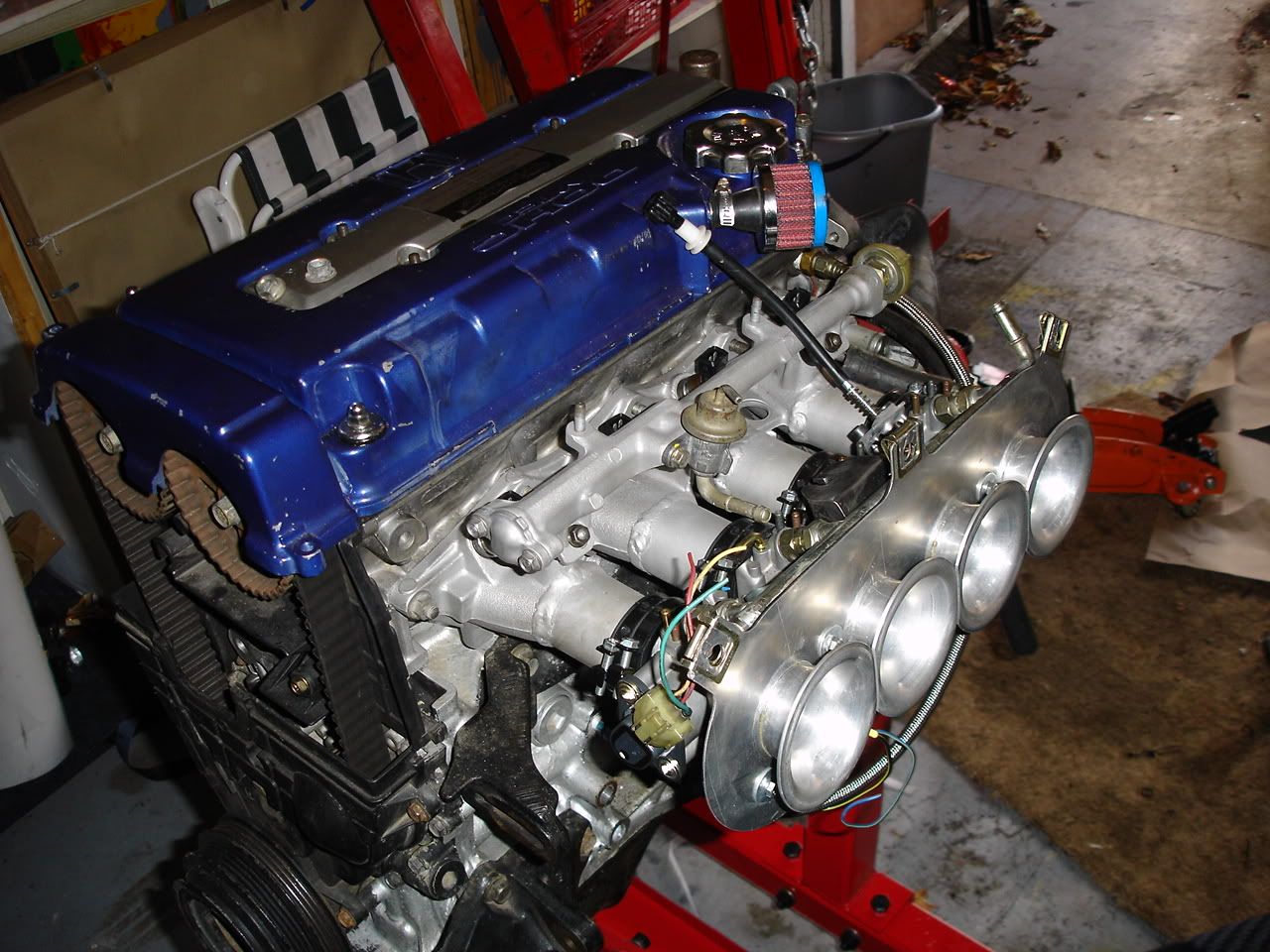

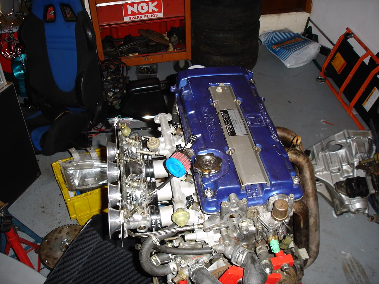

He has Individual throttle bodies to go on but is running it in on a Skunk2 inlet then fitting the ITB's and mapping it.
Has a pretty base map at the moment with VTec kicking in at 6400 and limiting at 9400
Did a RR run today and got 220BHP and 150N/M so a new higher map will be sorted when its run in properly - Then fit the ITB's :-)
D2 Coilovers and fancy lower and upper arms etc.
Front + rear strut braces
Four brach - DeCat and full system exhaust.
Polished crank
Block Guard
JE High Comp pistons and Eagle rods (12.4:1)
Crower Stage 3 cams

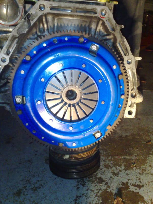

Fidanza Lightened Flywheel and F1 stage 3 clutch
'96 Integra gear box with Cusco mechanical diff and a Temporary Skunk2 inlet

/\ /\ /\ Trial fitting the ITB's and all the gubbins thats gone into the engine.
