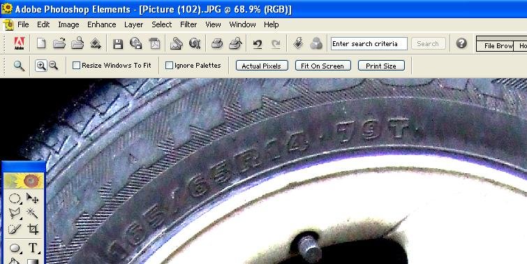

What is the profile on my tyre?
Is it in this bit
(cant check, dont have car.)
If so, what is it?
Thanks x

65

yea just quote 165/65/14 when they ask your tyre size
(if your getting quotes for new tyres)

165 is the width
65 is the profile whch is a pecentace of the with
and r14 is the diameter
14 being inches
