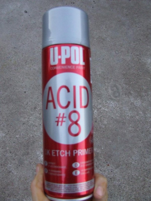

Originally posted by Graeme
is it in 2k primer or just etch primer?
seems very cheap!
I sprayed it all over in a couple of coats of this -
So, what ever that is.

hmm, kinda needs to have some 2k high build on it and flatted as that wont cover any filler scratched in it or imperfections.
Go to the bodyshop, ask them to just high build the outside of it and guide coat it, get it back and wet flat it all of it and then take it for paint, will be about £25 more if they can put it in with another job but well worth it

Would i be able to do any of that myself?
although finding somewhere i can spray it myself would be a bit hard with current weather conditions tbf
Edit: NB i want to do as much of it as i can myself, im pretty annoyed at having to send it off for paint

erm u could get some upol high 5 but it doesnt give the build as well and is about £15 a can.

Just to clear things up in my head a bit.
They will high build on top of the etch primer coats ive put on, yes?

yah
