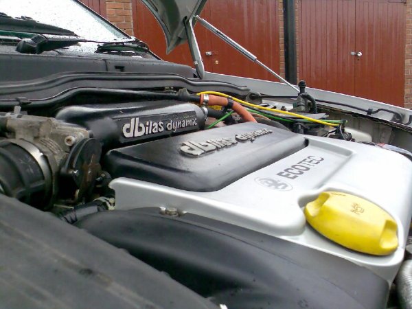

dbilas
my engine
[Edited on 22-08-2007 by Adam-D]
