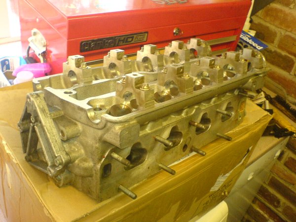

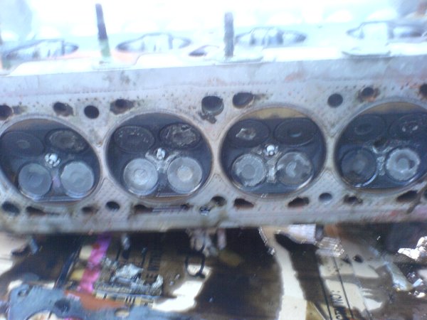

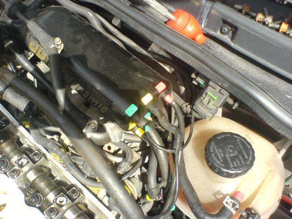

Started about 1 today when my mate finished work, had a few problems including snapping a head bolt but all in all its not gone to badly after that..

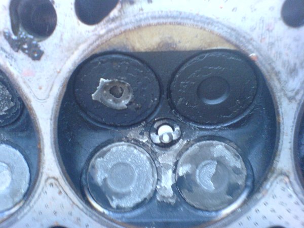

Found the culprit that is making it smoke ( check out the picture of the valve and the whole in one of them
New Head
Labelled up

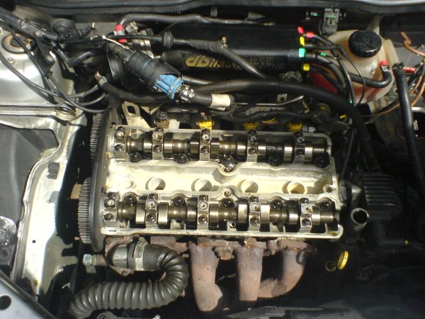

Rocker cover off and lots of bits disconnected

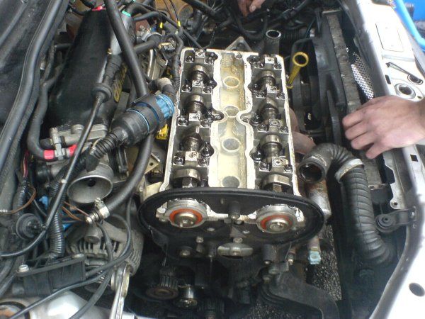

Pulleys off
then the Head came off one bastard head bolt snapped which we had to get the grinder on, but got it out eventually
These 4 valves in the picture below are the valves from cylinder two which was low on compression.
think you can see why one has a hole in
Picture of all 16 valves

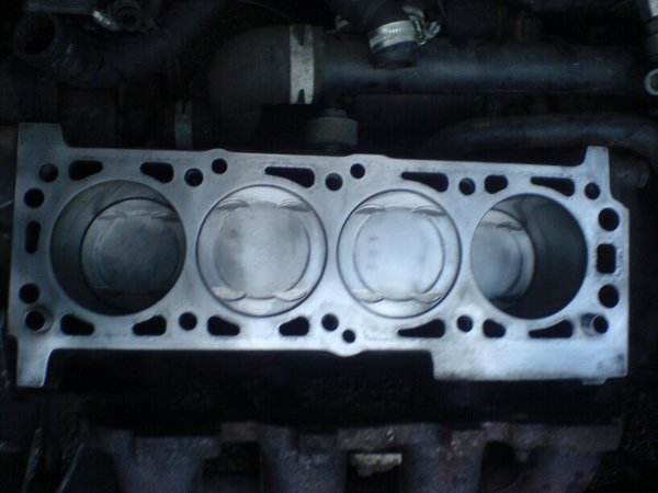

Picture of the bottom end all cleaned up
Thats it for today, will update more tomorrow

very interesting to see what condition the head was in. You should see quite a gain in performance with the new head on! Good work rob
Corsa C Z20Let
Black Sleeper Turbo Project
Rob B
Registered: 8th Jan 04
12th Aug 06 at 19:48   View User's Profile U2U Member Reply With Quote
Yeah one valve on cylinder 1 isnt far off doing the same so deffiently needs changing Cant wait to see if there is any difference, in theory there deffinetly should be

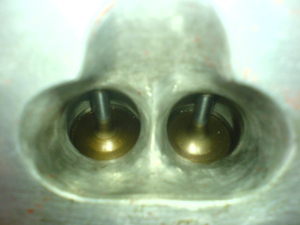

its all ready ported and had the SAI reground out of the exhaust port's too

how did it hole a valve?
Rob B
12th Aug 06 at 22:03   View User's Profile U2U Member Reply With Quote
Not a clue i dont know how it can happen ...

probably running lean may be worth investing in an adjustable fuel pressure regulator if you dont have one already
yes, I would look at the fuelling. Not necessarily the pressure though, more likely to be specific to that cylinder so I would fit some different injectors (rob I have a spare set here that are good) get the head fitted and get it running for 100 miles or so. then take it to a rolling road place for a good check over.

he did mention cyl 1 going too, somthing definately not right and i would certainly suspect lean running..
but yeh, may be woth changing the injectors or even having them ultrasonically cleaned and tested
Rob B
13th Aug 06 at 11:54   View User's Profile U2U Member Reply With Quote
well it was running on the wrong ECU for 5 months and popping flames etc with that ECU then when i changed it , it ran better so that may of caused it.
