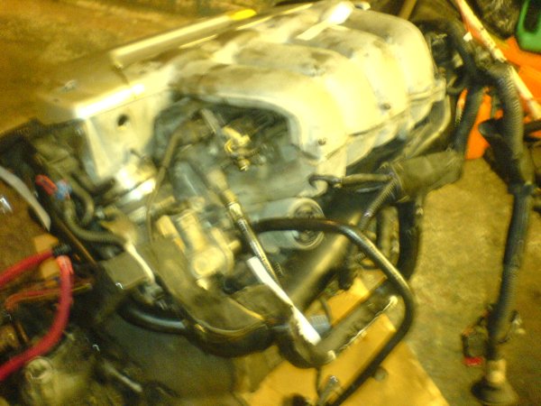

Air mass meter ?
ICV ?
Throttle Body ?
Whats the blue and brown wires ? I have the connector to go with them ?
Air mass meter ?
The pipe above the wires with the clip on it ? Heater matrix ?
Idle control valve / motor should be here ?
Sorry to be a pain on the arse just need to know what needs ordered etc

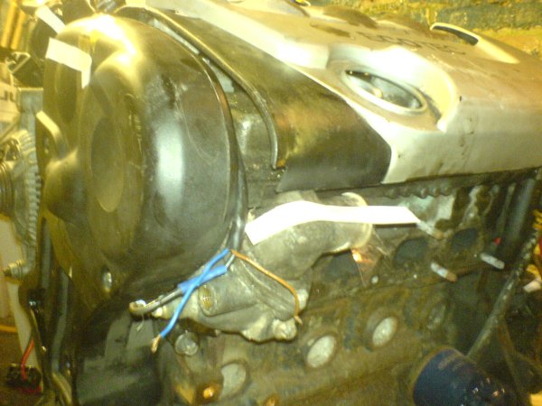

the brown and blue wires are for the coolant temp sensor...
its hard to see if the trottle boddie is missing cos your pics are blurred... but if it is then the ICV is attatched to it so that will be missing...

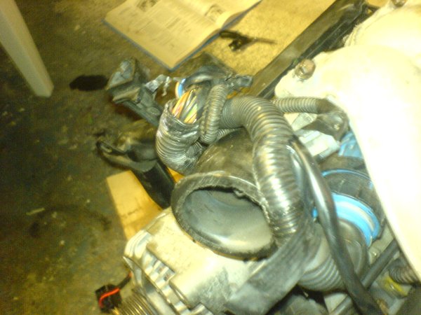

looks like the throttle body is there, but the piping that goes to the air filter has been butchered. the icv is attatched to the throttle body.

blue and brown wires are for the cts, you will need a manifold of course and a map sensor. check if the knock sensor is there (bolts into the back of the block between cylinders 2&3)
if you need any bits, i probably have them spare.

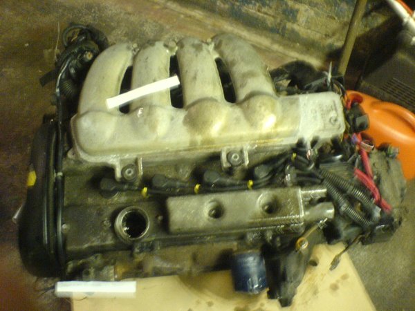

Got the manifold and sensor,
Not sure what the knock sensor looks like ?

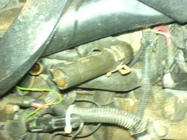

4th pic - coolant temp sensor, sho9uld be a blue plug attached to the end of those wires, looks like they literally ripped the sensor out...
tbh would need better pics for others...
icv is also connected to the throttlebody, so will be with that

I have that plug with it paul

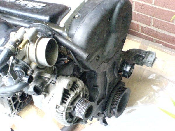

Whats this I'm missing , which is on Rob B's engine ?
Will get better pics

you mean the bit above the alternator?? thats the tb, as he has a dbillas inlet, its moved from the otherside!

Bit above alternator with gold pipe,
You have any good pics of a standard x16xe ?
Cheers
Gregor
PaulW
Registered: 26th Jan 03
20th Feb 06 at 23:02   View User's Profile U2U Member Reply With Quote
ahhh right the bit above the alternator is the throttlebody, on your engine, it is to the right of the engine (other side to rob's engine) and is attached to the big cast alloy inlet manifold on the top of the engine!

What about the air box where Im being told its butchered ? Whats missing there?
Thanks a lot for the help
PaulW
20th Feb 06 at 23:10   View User's Profile U2U Member Reply With Quote
cant reemember the name of it, but there is a sensor missing there, plumbs into the inlet just after the filter (you can see it on pics of my engine)

aye the throttle body on robs engine is above the alternator as he had dbilas fitted.
your throttle body will be on the right hand side of the engine looking at it from the front.
the inlet pipe the goes from the air box to the throttle body isnt there is it?big plastic tube goes round the back of the engine?
the sensor that plugs into the inlet pipe is the air flow sensor is it not?
