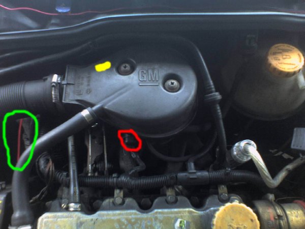

ith idles control valve is the part circled red
Cheers mate, but unfortunately my engine bay looks nothing like that
that it?
Lotus Elise 111R
Impreza WRX STi
PaulW
Registered: 26th Jan 03
25th Dec 05 at 23:47   View User's Profile U2U Member Reply With Quote
yes looks like it!
you should notice it adjusting the throttle position during idle if you watch it closely!

That pic is of the ICV on a 1.0 12v or a 1.2 16v .
First time you just cleaned the throttle body with some carb cleaner yeah?
My idling was poor and i replaced ICV and all was good
