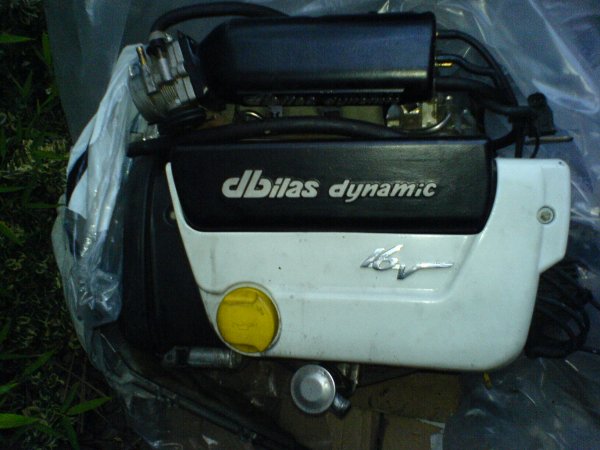

ah yeh i had problems getting my x16xe to start once id dropped mine in
i tried switching the plugs for the injectors around as i could remember which way they went
eventually i put my finger over this hole where the air intake pipe goes next to the throttle butterfly it sucked ma finger in like it was a vacuum will jus see if i av N E pics
Rob B
Registered: 8th Jan 04
9th Nov 05 at 17:52   View User's Profile U2U Member Reply With Quote
fuel lines are braided and screw on and only go on one way i believe ....
injector plugs are all fine... vacuum hose a pic would be good cause i dunno what your on about , did this help your car to start ...
CoastalCorsa
Registered: 7th Jan 05
9th Nov 05 at 17:55   View User's Profile U2U Member Reply With Quote
when you press the accelerator it moves a circular disc which can be seen if you take off all the air intake pipe
when you look at it you will see that it is closed jus infront of this there is a small hole which allows enough air thru for the engine to tick over at idle speed
i put ma finger over this hole as to block it off then i tried starting the car
for some reason this worked for me
i got the car running an revved the engine from under the bonnet then removed ma finger at all was well

CoastalCorsa
9th Nov 05 at 18:06   View User's Profile U2U Member Reply With Quote
top left of pic there is the silver metal bit attached to dibilas
in side that there will be a small hole on the inner bottom
put your finger over it an try start the car
