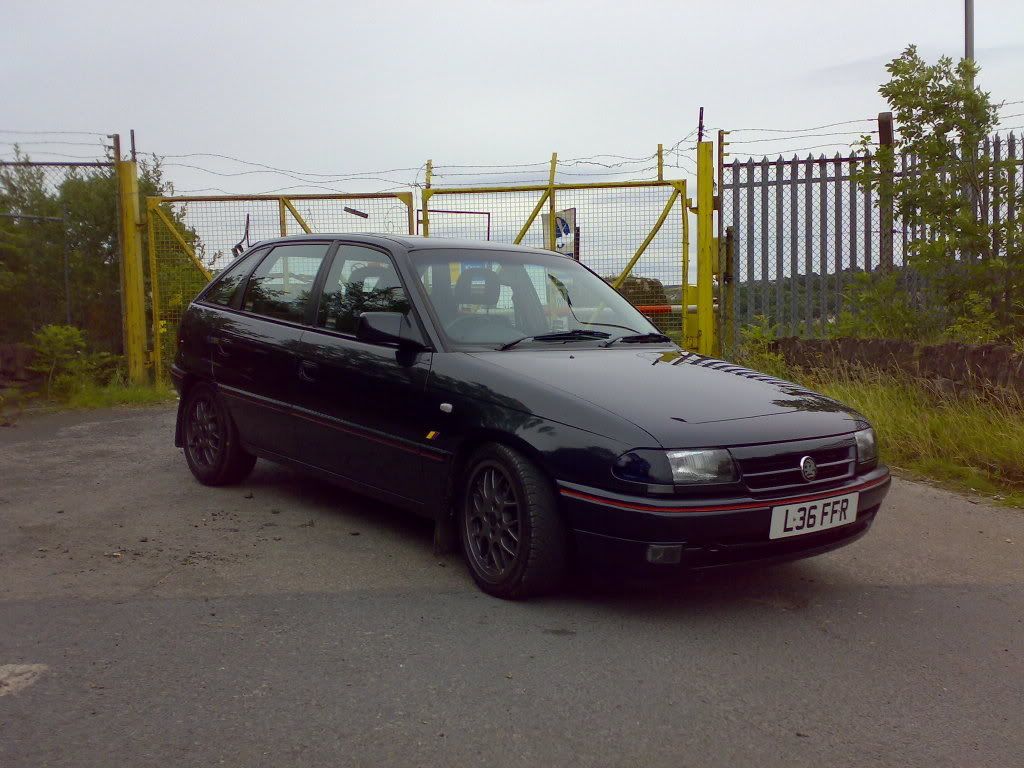

finally had chance to sort the paintwork on the astra today.
Cleaned
Clayed
Cleaned again
Paint Cleaner
Polish
Sealer
Wax

So you didnt seal the wax after all that hard work?
Looks clean mate very nice job
willhouse
Registered: 11th Jul 06
Location: Sheffield
28th Jul 07 at 20:17   View User's Profile U2U Member Reply With Quote
seal before wax as the seal doesnt like going on top of the wax as it is too greasy

what ben said, you use clay to remove the tiny stubborn bits of dirt that you cant easily see but you can feel of you run your fingers over the paint.
so yes- you do clay before polish
28th Jul 07 at 20:32   View User's Profile U2U Member Reply With Quote
paintwork is absolutely brilliant by the way
what does the paint cleaner do apart from the obvious? never used it before.

just a slightly harsher polish i think really, but it does make polishing and waxing alot easiler if you paint clean beforehand
willhouse
Location: Sheffield
28th Jul 07 at 20:35   View User's Profile U2U Member Reply With Quote
you use a buffer or do a machine polish to cut back the top coat a bit to remove swirl marks or paint imperfections

Meguires Quick Clay with Quick Detailer Lube,
Meguires Paint Cleaner
Autoglym Super Resin Polish
Autoglym Extra Gloss Protection
Meguires Carnuba Wax
