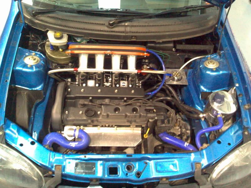

Heres what im looking at. Not my car, same set up though. Bare in mind no trumpets are fitted here also.

6th May 07 at 16:07   View User's Profile U2U Member Reply With Quote
choping is the only way its going to fit from the looks of it?

6th May 07 at 16:09   View User's Profile U2U Member Reply With Quote
either chop it or run no filter...
probably better off chopping it out, so as not to starve the trumpets of air so to speak

Hmmmmm didnt want to have to to if i can help it. Id like to be able to put the car back to standard.

u may be able to get the manifold made so that the angle up more!

Air flow will suffer slightly. The above manifold is only £99. Think it may come to some bulk head butchery after all.
6th May 07 at 16:16   View Garage View User's Profile U2U Member Reply With Quote
If you cut very carefully, you might be able to have it welded back in and filled over at a later date.

I like the coke bottle oil catch tank in the above pic!

6th May 07 at 16:20   View User's Profile U2U Member Reply With Quote
on the pic above, you could gain more clearance using shorter silicon joiners between the manifold and TBs. then use 25mm trumpets and a filter like Dave A with the back plate welded to the trumpet mouth's

6th May 07 at 16:27   View User's Profile U2U Member Reply With Quote
What filter does Dave have? Anyone know where you buy those ram air ones? I need trumpets as long as possible really for optimum performance.

6th May 07 at 16:35   View User's Profile U2U Member Reply With Quote
Originally posted by Butler
http://devboy.com/photo/data/500/medium/S4020807.JPG
I have one of these engines now.
Significantly smaller capacity though unfortunately and also missing some of the nice stuff in that pic.

6th May 07 at 23:20   View User's Profile U2U Member Reply With Quote
I have those filters in stock mate, really really good for saving space. I use it to clear the bonnet as im using a 60mm long inlet manifold, 118mm long tb's and 90mm trumpets, just weld up the backplate to the underside of the bellmouth and gives plenty of clearance.
u2u me regarding a backplate, trumpets and filters, can do them at 25% off RRP.

Sock filters over the trumpets?
