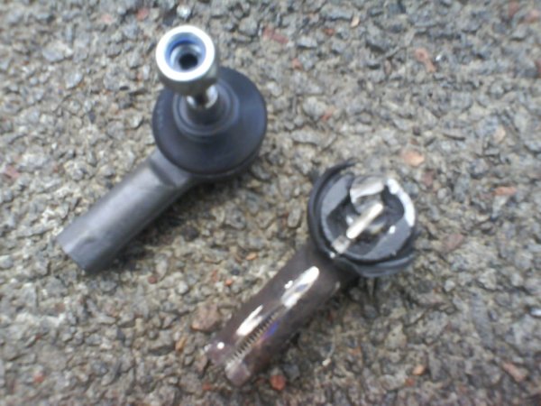

Was at it for AGES , trying to get the fucker off. In the end out came MR Angle Grinder.
Fucking rusty bolts

why did you not just unwind it from the steering rack and cut the bolt off?

It wouldnt come off beardy , absolutley NOTHING, was getting it off !

Oh yeah , and the thread you can see inside that cut on the track rod end is not from the actuall rod
Just incase anyone thinks that I chopped the lot off

i did think that
then looked again

lol the photo is misleading !!
I made four cuts that close to the thread , then bent it out with a screwdriver and finally it came off.

I would have given up and got a new rack

I had the same problem on both of mine took ages so out came Mr angle grinder. :

On my brother's old Cav the mechanic dude remove the track rods with the ends still intact, then he got a blow torch to the ends and heated them up, occasionally spraying WD40 in the path of the blow torch for some reason!
No one could sort this out, not even Vauxhall! Vauxhall wanted to remove the steering wheel and put it back on an angle (ie. not straight)...
