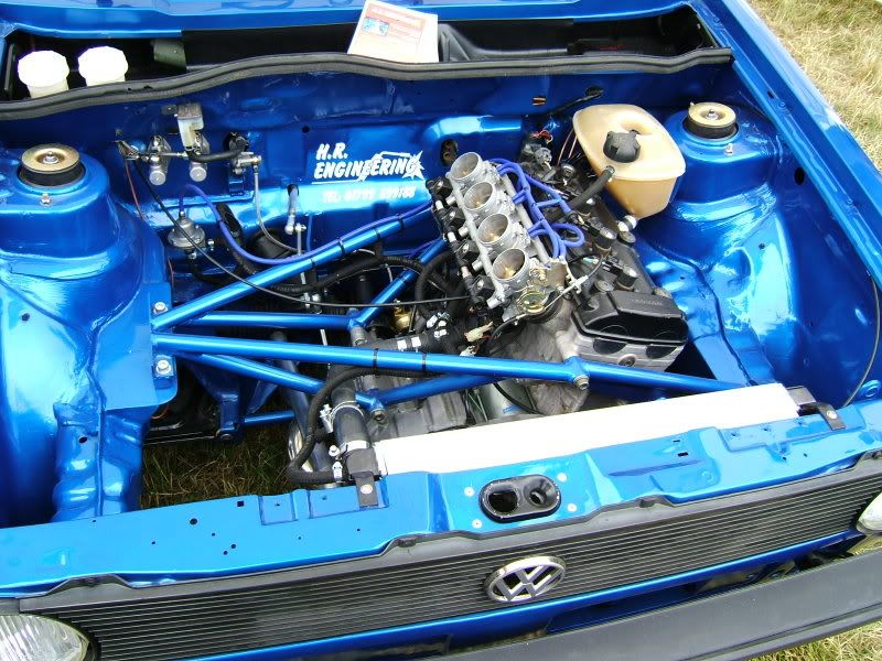

won't of thought it would be too hards, gearlinkage quite simple due to it a sequental gearbox, simple wiring (just use the motorbike clocks/intrument)
only hard would be to get drive, due too single sprocket, would have to be a chain to a bigger spocket (to adjust gearing) with would then go to the drive shafts. problem being it would be a like weilding your diff up!
dont no how you get round that
and if you want torque, get a Vtwin/v4 fireblade or something or even a single

Thought about this briefly for mine. A CBR1000RR (my mate conveniently has a crashed damaged one ) has the same power as my TB'd 1.6 16v. Unfortunately the bike engine has a pitiful amount of torque (circa 80lbft IIRC) this would make it useless even in my featherweight nova.
I believe the gearbox issue could be sorted quite simply, as all the RWD rear engine conversions have already been done, the simple solution would be to use whatever box they use!
20th Nov 06 at 19:45   View User's Profile U2U Member Reply With Quote
Originally posted by VXR
With a bike engine being so small, it wouldn't take that much welding to create the appropriate engine and box mount points...
Make it RWD will require a whole rear frame setup, floor cut away etc... Much kmore £££
Pleaseeee... You still have to convert it to run chain drive which means mounting a custom diff and driveshafts which is a ball ache...
