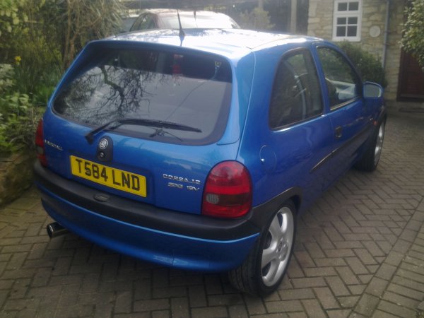

davegreen
Registered: 20th May 12
Location: Oxfordshire
9th Jun 15 at 17:29   View Garage View User's Profile U2U Member Reply With Quote
Originally posted by basslinecorsa
Originally posted by davegreen
there is an off the shelf kit for the corsa c z12xe, same engine apart from ecu, and fly by wire throttle.
so there are parts out there only not cheap!
http://www.dbilas-shop.com/Products/Turbo-charger-systems/Retrofit-turbo-Kit/Turbocharger-system-Maxi-Edition/Opel-Vauxhall/Agila/Turbocharger-system-Maxi-Edition-for-Opel-Astra-G-Corsa-C-Meriva-A-Agila-A-1-2-16V-Z12XE::276.html
160 bhp from a 1.2 ..... bet that can surprise a few people !
like my old x12xe did,
[img][/img]
say's 1.2 on the back but 226bhp x20xev up front
