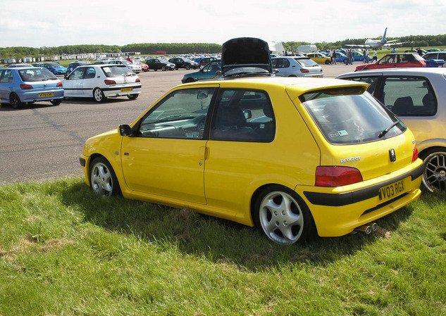

White is a lush colour in them, hard to find in s2's
Nana ftw!
My one
Looks good polished
