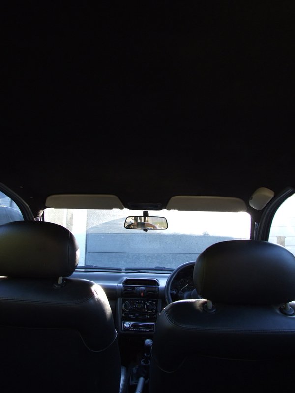

as promised a couple of new photo's of the Black headlining fitted & the painted roof rails (marmite)
The original idea was to paint the roof rails with a gold pinstripe (match the wheels) but i couldn't get any smoke grey paint mixed in time, so they are currently just painted white gold & lacquered.. if it doesn't work or grow on me then i'll mask up and base over with the smoke grey to leave the gold pinstriping next time i've got the guns out.
As for the headlining, i tried to re-trim but found that the material didn't stick very well and ended up sagging in places, my only other option was to use fabric paint, looks much better imo.. As for the sunvisors, i'm trying to get my hands on a sewing machine to have a go at re-trimming them in the suede material i used on the door cards.

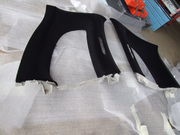

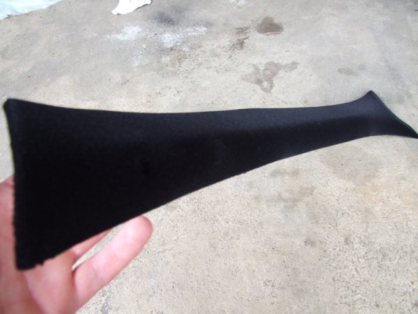

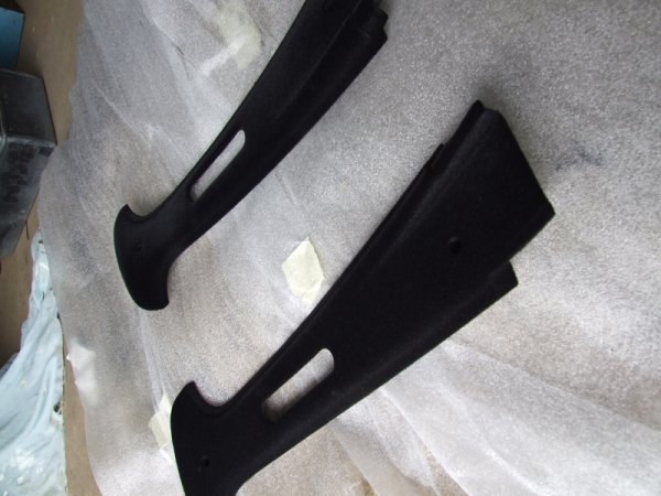

Today i got a few more flocked bits through
Grab handles
A pillars
B pillars
C pillars
Center console (forgot pics :lol I've also put some black sunvisors in the car & have fitted the flocked door pockets too.

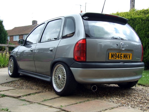

small update:
Have noticed cars with all red rear lights as standard (peugeot) and i quite liked the clean look about it, i wasn't too sure on the legalities and wasn't sure if it would effect the light output from the indicators etc. so after a bit of reading into it i thought i'd have a go at tinting my rear lights.
i took the lights out & cleaned them with soapy water then spirit wipe, i then used red tinting spray in light even coats.
once covered and happy with the colour i left them to dry & noticed they were patchy and still quite matt, couple of coats of laqcuer brought back the gloss and they look as good as new
before:
http://www.corsasport.co.uk/carimages/6541/dscf0337.jpg
after:
indicators still glow orange, reverse does have a slight pink tint to it but you can still tell the difference between that and the brake/side lights. Have read that using a green bulb in red tinted lights will also work as the indicator.
